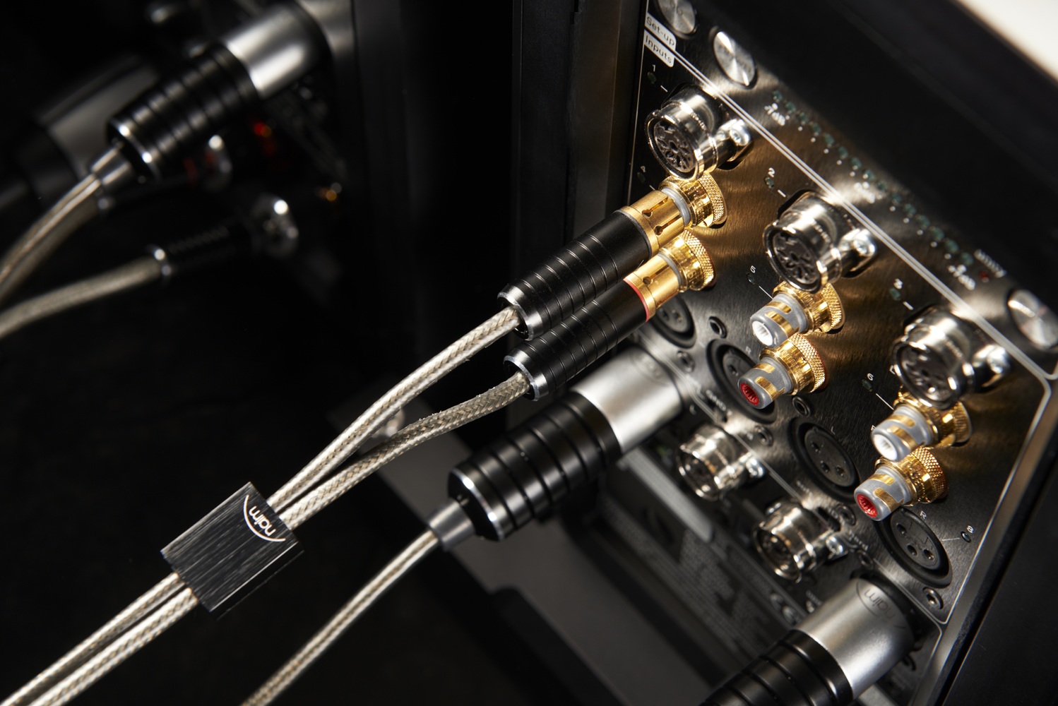

4. Cable Dressing and Layout Best Practices
Proper cable management—also known as cable dressing—is essential for minimising interference and preserving signal integrity.
Voltage Awareness
Cables in a Naim system carry different voltage levels:
Voltage Level
Cable Type
High
Mains cables
Medium
Speaker cables
Low
Signal interconnects
  • Keep low-voltage signal cables away from higher-voltage mains and speaker cables.
  • Avoid running cables in parallel—cross them at right angles where necessary.
Physical Placement
  • Let signal cables hang freely in space where possible.
  • Avoid resting cables against walls, floors, or furniture to reduce the impact of microphonic vibrations.
  • Naim interconnects and SNAICs are designed to hang naturally with minimal strain on connectors.
Environmental Considerations
  • Avoid routing speaker cables near electrical ring mains (often behind skirting boards).
  • Keep cables away from power supplies, transformers, and Wi-Fi routers to reduce interference.
