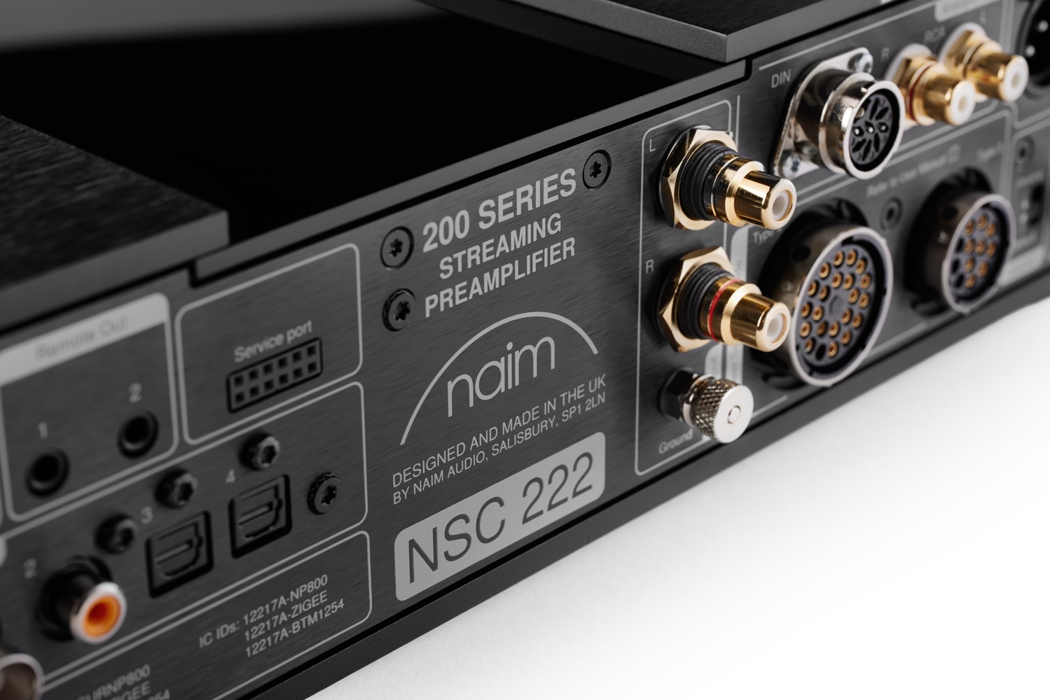

Connecting a Phono Stage
The NSC 222, Supernait 3 and NAIT XS 3 are all fitted with a built-in moving magnet phono stage, but for the remainder of the Naim ranges, you can connect one externally.
How to Connect:
  • Using a Naim phono stage (Stageline or Superline, with accompanying power supply where applicable), connect your turntable’s arm leads and earth wire.
  • Connect the phono stage to an available analogue input on your Naim device.

Selecting Output Sockets
Some Naim streamers allow you to choose between signal outputs.
How to Select (ND555, NSS 333, NDX 2, ND5 XS 2, NSC 222):
  • Open the Focal & Naim app
  • Go to Settings > System Settings > Output Settings
  • Choose RCA, DIN, both of these, or digital, depending on your setup
DIN is preferred for best performance when connecting to other Naim equipment.
